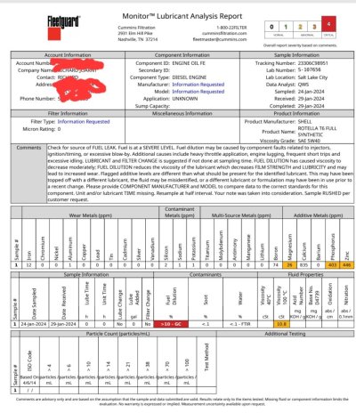

6.7% fuel at 500 miles is outrageous. That thing is ****** fuel.
If it were mine, nope. New truck please.
Here was the first round. 400 mile trip.

This is the latest oil sample, ran for 500miles on a fresh oil change.... the dealer also over filled my oil so the % is not right for normal oil level to start.View attachment 537027
With just 6.7 fuel in oil did they add a gallon of Lucas oil additive to slow the diesel fuel getting by the rings
