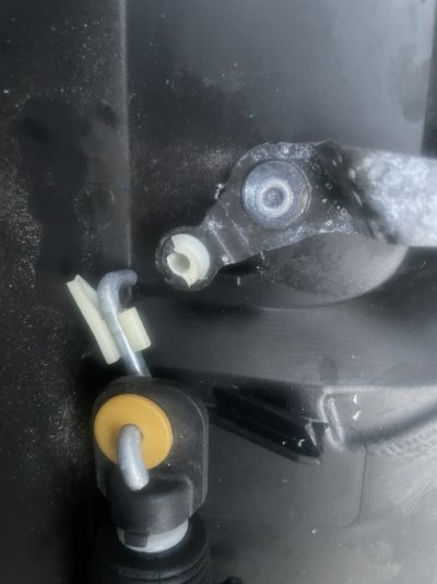

0B21C86F-7657-4E59-B559-64030395E982.jpeg4F70083F-B45C-45AD-B50B-6E202AE3000A.jpegfinally got some time to mess with my truck. fixed the box lock. took 15ish minutes. super easy. gonna buy some more clips before prices skyrocket anymore. i can see this being an issue again in the future with the other clips.

Glad you got it fixed. I bought some metal carb linkage clips for mine for the next time this happens.

Yes. I bought an assortment, kind of like this one. I'm not sure exactly what size is needed as I've not had to use one yet. I replaced both of the broken stockers about 1.5 years ago with the Mopar part and so far, so good with them.
