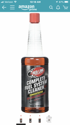

I typically run Mobil or Sunoco, where I was last weekend I had no option but to get no name gas.
Burla
Apr 28, 2012
27,560
57,805
2010 Hemi Reg Cab 4x4
^^^ A must when you use no name gas imo. 1/2 bottle make a good treatment, 5 bucks.
