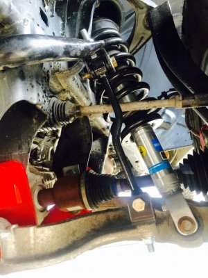

I installed my rough country 4" lift kit and I may or may not have installed the sway bar links incorrectly. Which way does the bend face? Pics would help! Thanks !

Called and finally got thru, I had em backwards. Well I had the brackets right but the linking bar can be put in either way. See pic for the correct way.
Note: use WD-40 on the rubber bushings to get them in. Hence the spray marks everywhere lol
