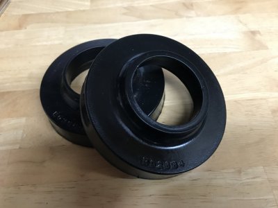

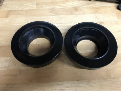

Daystar isn’t really “plug and play”. Got mine from Amazon.
It replaces the factory isolator at the top of the coil but there is a cone that comes down from the frame into the isolator, hence into the new Daystar spacer.
The opening in my spacer wasn’t quite big enough for the cone to go into it. Had to shave some away. Started with a manual file then went to a Dremel. Much easier that way.
But still. It needs trimmed. I too got Daystar because I was ready and TGC didn’t have any I guess from being bought out.
