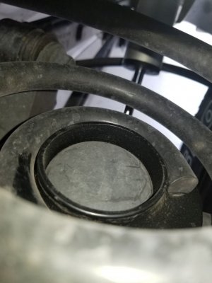

Bringing this back to the top. FWIW, I did install the 3/4" poly spacer (spec'd for a Jeep) in the rear of my '16 Ram. 3/4" is most I would recommend using a poly spacer though. The way it fits, the bottom of the spring sits over the pad, there's still about 1/4" of factory spring locator to center the spring, but it's not fully engaging the spring like the factory design. I'd be cautious of using a 1" poly spacer. I think anything more than 3/4" would need to be made of metal. I'm going to watch this closely for signs of spring shifting , have a feeling I may be swapping these poly spacers out for 1" metal.

I have not seen either issue in any I have installed. They all went on perfectly even the 1.5" spacer

1.5" poly? good to know, my concern was if the poly would keep the spring centered long term under HD use. The 3/4" Jeep spacer is open, there is only a small lip to center the spring. I would assume the 1.5" poly spacer maybe is made different?

They are identical to the TGC spacers which I bought one set of years ago only to find the TJ , XJ and one of the Grand Cherokees were exactly the same . As a matter of fact the TGC spacers are mixed in with the rest of my collection of old Jeep spacers hanging on my garage wall and I couldn't determine which spacers are which .

1.5 is the same style as the the 3/4 just the bottom naturally is 3/4" taller, Your spring has nothing holding it in place so if your shocks are long enough for the spring to unseat when the axle droops it will be the top of the spring that should become unseated thanks to gravity .

Based on my measurement 28" extended is max for me and the coil is walking around.
So, if you go get an oil change the coil is coming out.
