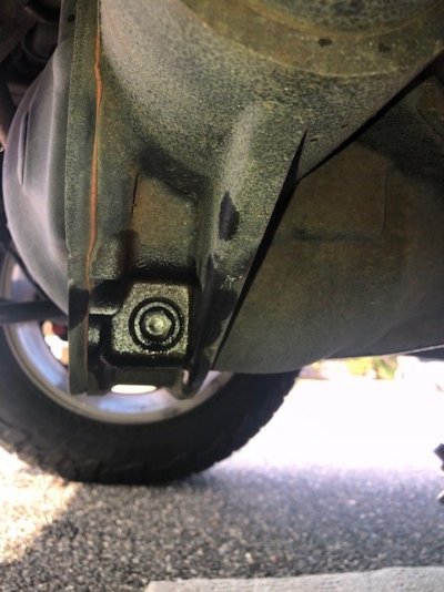

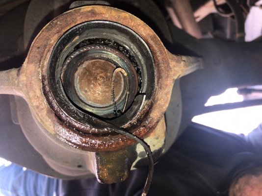

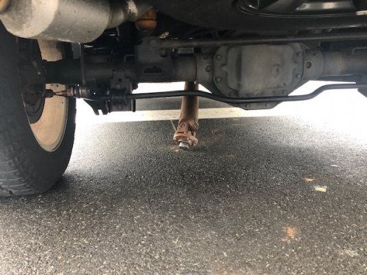

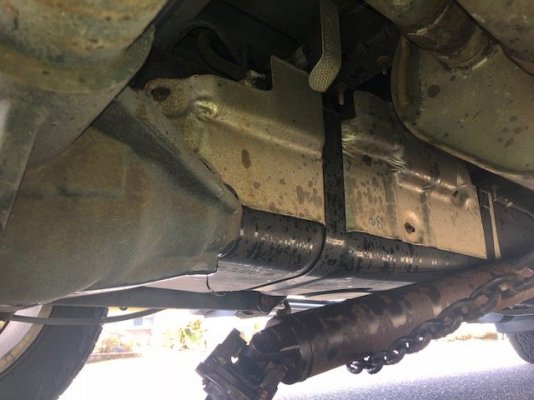

Hello all. My vehicle is a 2016 Ram 1500, 5.7, crew cab, big horn. currently around 54,000 miles.
So yesterday I went to the local oil change place to get my oil/filter changed. they suggested change the front & rear differential fluids be changed as well. I said ok.
the receipt says they put in 75w90 x 2.4 pts in the front & 75w140 x 4.6 pts in the rear.
Mileage in was 54103.
I drove home, maybe about 2 miles away. took side roads. did not go over 50mph. No issues.
today i got on the expressway and i smell a burning oil smell and the truck is kind of "holding back" when i let off the gas pedal. the same feeling you would get if you were to put you car from "drive" then shift into "2" or "L". that sensation. I got off the nearest exit and now im on the service rd heading towards a red traffic lite and i hear a snap/bang sound. then a dragging sound. i feel no forward power when i press the gas and now the engine is sounding very weird. as if it were getting flooded from too much gas or something. I stop at the red light. now the smell is very bad and the engine seems to be stalling. i put it in park and shut off the truck. i get out and the truck starts rolling backwards because i am on a slight incline. i hop back in and press the brake and emergency brake. i get out and look underneath and find the rear driveshaft snapped and hanging on the street. see the attached pics. the mileage now is 54112. Ive driven 9 miles.
how can it be that a driveshaft snaps like that? any thoughts? looks like a clean snap.

That is not your driveshaft that broke, that is the pinion in your rear differential that snapped.
Did the lube shop not put any oil back in it??

I honestly don't know what they did under there. i was sitting in the car while it was all being done. but there was a little bit of fluid splattered on the bottom of the car, as you can see in the picture. nothing was dripping out when it was stopped in the street, but then again, i was stopped on an incline which would force the liquid back into the unit. there was some fluid that leaked out onto the bed of the flatbed. it looked new & clean. maybe there was not enough fluid put back in that caused a seize in the rear end gears? fortunately for me, it did not seize the rear tires, but instead produced enough torque to snap that pinion?

Thats a broken pinion gear . I would call the mechanic that said he put 4.2 pints of oil in the rear end ? I would also check the front differential, Just sounds suspect to me that it happened after you had it serviced . Wow.

Oh man that sucks on such a low mileage nice looking truck. Like said, if you're going to pursue the oil change place, I'd get the cover off the rear diff and take lots of pics. If it had no or very low gear oil in there there will be all kinds of gear and bearing carnage in there. It was enough to lock up the works and cause the pinion to twist itself apart.
From the sounds of the time/mileage frames, the burning smell, sluggishness and then the bang, it sure does sound like a lubrication related failure.

I also think that they forgot to fill it, filled it with something else, left the drain plug out.
I guess it is possible that it was just a coincidence but that would be just horrible luck.
Drain plug is in place. good thought though.

The pinion going bad might be a sort of clue: A rear diff can be quite low on lube and still function and lubricate. Oil is licked up off the bottom of the diff and gets slung toward the front via a channel. That's how the front bearing gets it's lube. I've seen diffs pretty low on lube still function undamaged. Then the oil that lubricates the front pinion bearing makes its way by gravity down a trough past the rear pinion bearing before dropping down to the bottom of the diff housing. The side bearings can probably get by under low-load conditions in a cool environment by whatever tiny droplets of splashing oil get on them. Obviously not ideal, but rear diffs that are rather low do seem to survive under low-strain conditions. Side axle bearing races actually 'hold' some lub by the way they are designed.
So, the pinion going first 'could' be an indicator that there was no oil in the diff. Or... maybe the bearing just gave out. Not likely but that does occasionally happen. But I'm going with the no-lube scenario.

I'm not sure that this would be from oil in the differential. You would hear the gear whine way before the pinion would seize to the point that the pinion gear would snap.
I would think it is something that got trapped between the pinion and ring gear for a second.
