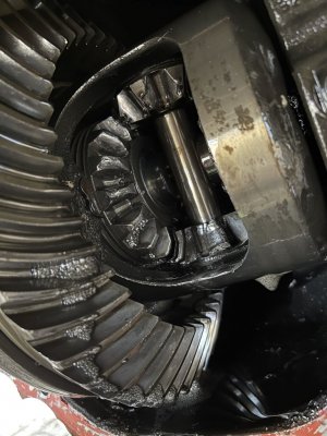

Pulled the rear diff cover off my 15 1/2 ton sport, after it was making a terrible noise when turning. This is what I found. Any advice, or upgrades over the factory LSD I should take advantage of? I had a rear diff oil change about 8 months ago they claim a LSD additive isn’t required with the 75w-150 severe gear oil but it’s the only thing I can think of that would have caused this damage.

The damage pattern looks to me like the differential was trying to lock up as the pinion powered through the ring gear - look at the pattern where the pinion enters the ring, and where it exits.
If this damage was done on just one revolution, there may be something loose in the carrier (a bolt?) that caused the broken spider gear and progressing the to the pinion/ring mesh.
Should be disassembled and evaluated by a failure analysis expert.

I would be looking at the Pinion Nut & seal, where the driveshaft bolts to it
If that nut loosen up, it will destroy a rear end
That may not be your culprit, but i would still check it

Nothing to do with additive, but that additive is in every synthetic gear oil unless you specifically order a lube w/o it, and those aren't on the shelf, so likely no issue anyhow.
What was happening at the time it failed? Snow or anything that was slippery and then you all of a sudden got grip?

Whats up with all the bubbles in the left over fluid? Or are we thinking its just fluid that got churned once the failure happened

What kind of driving have you been doing? Off-roading? What's the tire setup? How any miles on it? Spider gears are a weak link in a differential.

An Eaton “ Detroit” tru-trac will make a very good replacement for your situation, maybe a gear ratio change also,if not 4x4.

that spider gear issue is very common on jeeps with lsd rear end. I personally know people who that has happened too and Jeep warranties it so if you are still in drivetrain warranty they will install new spider gears and what ever else was damaged.
