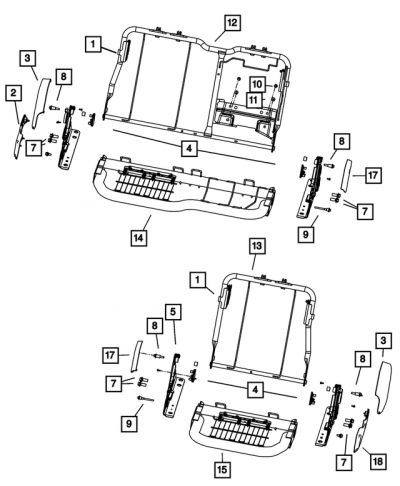

Thank you for the part number. I too have been scouring the schematics and the forums. The number you gave me seems to go to the plastic pieces that cover the metal hooks. The hooks themselves are welded to the seat frame insice the foams. While I had mine laid down I undid the cover to check it out against the schemactics. The hook is labeled as number 1. I believe that I'll need both 12 and 13 as well. It looks like it'll be in the neighborhood of $450-500 for parts including taxes and all.

For that price I would check car-part.com and see if a junkyard close to you would have the whole rear seat. Should be a lot cheaper and a lot less time consuming.

Wow, an expensive fix
How can the hook be welded, it is an alloy, not steel? And if it is welded to the frame, why would they give it a part number? Doesn't make sense.
When I search the part number, it comes up described as a hook or retainer on every website and only costs 2.15-5.00. I don't see where it is only the nylon piece.
Not trying to argue or contradict, just sharing what I see. It would be nice if you could just replace them at under 5.00 a piece. Good luck

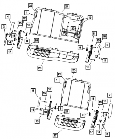

Is this the part that was screwed up ?
That is the broken, or completely missing protective plastic bit covering the metal hooks that anchor the seat back to the back wall of the cab and prevent it from rattling. Numbers 24, Mopar (68050769AA) and 25, Mopar (68050771AA) in the picture. The metal hooks are welded to the seat frame itself. There is a YouTube link on the first page.

WOW that suck they ruined the frame ? Thought you just had to replace the plastic piece, Good luck with the seat swap !
