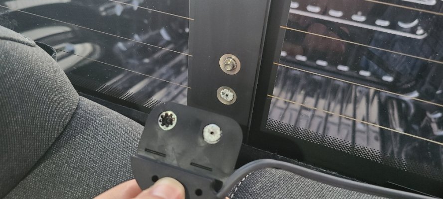

So, yesterday on my way to work I had the rear defroster on. I noticed the two stationary rear window pieces defrosted nicely, but the center sliding piece was not defrosting. Today I went and looked at it and noticed the power cord housing was crooked. It popped off in my hand and it's held on by two little button looking things. Problem is, the bottom "button" is broken off and still attached to the housing. Has anyone else had this problem? My truck is only a month old so I'm assuming it can be fixed under warranty, or will the dealership tell me it's wear and tear?696d7964643c1108a989e11de09861d7.jpg7c8a272bb1f4f217d267ca6ecf400b8f.jpg

It will be repaired under your 3/36 Basic Warranty. I fixed one last week for this issue.

Is there a do it yourself fix for those of us that are out of warranty? Mine didn't come off but the bottom piece is broken like the op.
