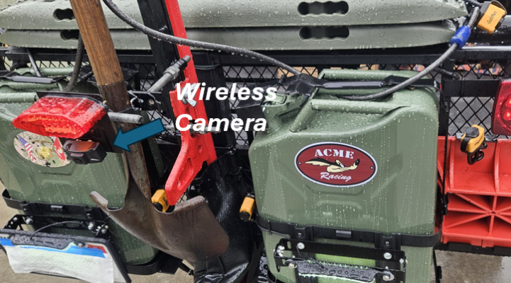

I bought my truck with very low miles/ used and was not able to order the option/ the harness for the extra cameras. Ended up going with a mail order $40 dollar wireless camera and small screen for the dash. This is the short-term solution until I upgrade the harness and hard wire a better system in.
The screen is more compact than it appears and fit right onto one of my Bulletpoint dash holder extensions, next to the phone.
I needed it to see behind the recovery gear/jack/fuel carrier I built.
This extends 3 feet back from the bumper (allows for full opening of tailgate) so the extra camera is a must.
