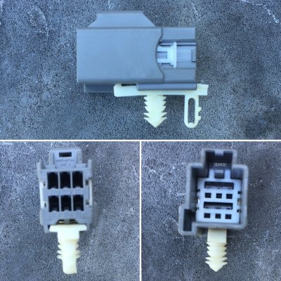

Wanted under seat lights for the backseat. Got confusing trying to piece everything together. Truck is a 2018 Express. Started with my bench under seat lights journey with this thingy not connected to anything:
Ordered wrong connector 68186565AA. No bueno:
Ordered the right connector 68217325AA so making progress:
Then the bezel 5KX15DX9AB clips onto the LED light:
Connector w/ pigtail matches connector on LED wire 55057286AD then bezel clips on:

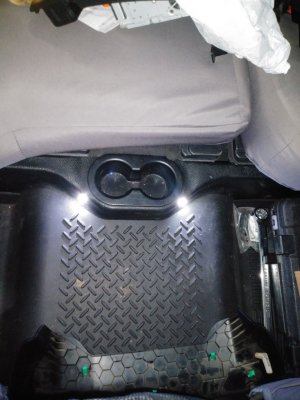

I bought some flush mount led's and drilled a couple of holes into the rear cup holder...I did have wires in the existing connectors under the seat, so I tapped into them under the carpet in the storage area...
