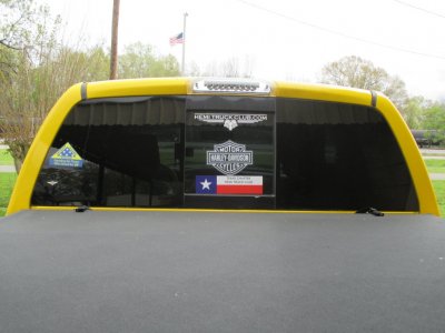

My 07' Quad Cab developed a water leak at the rear window. At first I thought it was leaking at the 3rd brake light so I sealed it with silicone. The leak continued so Friday I took my truck to a glass shop. The original slider window had been replaced with a like new unit before I bought my truck. The slider wasn't installed properly as there was a very small gap all along the top of the window. I had a non-slider tinted window installed. I have included a photo of the old slider and the new window.IMG_0713.JPG IMG_0593.JPG
