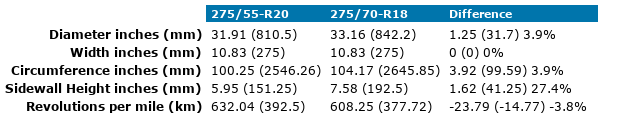

I’m picking up a 2020 Big Horn on Tuesday. It has the 20 inch chrome wheels. I’m going to swap them out for some 275/70/18 Toyo AT3’s and then I’m going to buy some 2019 Ram Rebel Rims - 18 inch. Will they fit fine on my vehicle? I’m not super educated on bolt patterns and all that. Just wanna swap the 20’s setup for the new 18’s setup. Thanks for any advice!

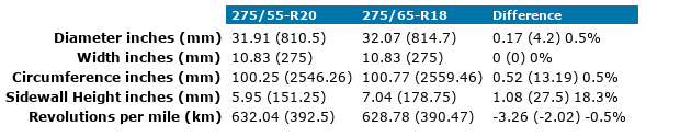

As for your current swap size comparison:
The 2020 Rebel rims will fit your truck as the all use the same bolt pattern, and your not up sizing the tire much so there shouldn't be clearance issues but the speedo will be off. T
The factory Rebel tires are 275/65/18 Those would be almost a match size wise to your current wheels, not enough to make a difference on the speedometer/odometer.

All the 6 lug Gen5 rims should swap between each other. Apparently I can't read correctly right now, the Gen5 Rebels use a 275/70/18 tire, the 275/65/18 is the standard tire size. D'oh!
