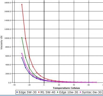

Both will take 5w30 perfectly. With all the known cam issues, going with a little more protection is a great idea, a little less then 1/2 the forum uses 5w30 in the last poll. 0w40 redline is nothing compared to 5w30 redline, it is that swing 0 to 40 that is the issue, more vii's. Hemi specific oil srt/pup 0w40 made for the hemi is way thinner then 5w30 redline towards the end of a run.
You can see what we see from the hemi specific oil 0w40 pup, clean base oil, high moly, 40 weight, however the vii's shear and the oil always end up thin through most of the interval. Redline is the same, great base oils and high moly, but it will stay near the same throughout the interval and will be thicker then pup 0w40 for most of the time. In my three uoa's my redline 5w30 was always over 12 cst and you see hammers was under 12 with pup, and he ran for a long time and it was always under 12 despite low miles on every oil change.
5w30 redline is pure hemi honey whether you have the 6.4 or 5.7. Like Hemiman said, if you get cold piston slap in winter then you go 0w30 redline, but if no cold piston slap just use 5w30 redline. 5w30's actually give you better cold protection in the winter then 0w40 as a matter of fact.
A 5w40 would be similar to 0w40 on this chart, as you see in cold temps 30 weights will be better performing. All the zero means is it is the best performance that weight can be, not that that oil will be thinner then a lower weight. Weight trumps winter rating, so other then warranty, I can't see any reason to use 0w40 over a well made 5w30, unless that 5w30 is api because there are less rules for 0w40, but since redline isn't api, it will be greater then 0w40. Generally 0w40's are very well made, but against that specific formula 5w30 redline, there is way more protection for any hemi. better base oils, way less vii's, high moly, more boron, more zddp, every thing a young hemi needs.
