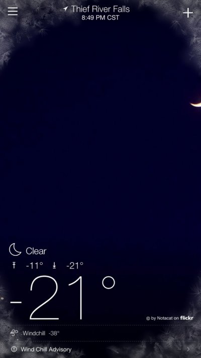

I have 5W-30 in my Ram...
A couple days ago still started.
Tonight a little warmer at my house.
