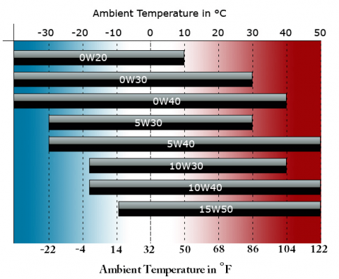

No expert but I think Iam going to go to 10w30 Redline when I change this month.
As you can see it flows well in cold weather.

As far as weights go, I've seen another chart like that.... So you'd say they're accurate? Hmm, okay, so what about 0w40, 5w40 and 5w50 weight?
This is the chart that had me thinking 5w40. I'm more likely to see the higher temps than ultra low with wanting to go out southwest some time. But, at the same time, this chart also had me thinking to mix 0w40 and 5w40 to split the difference. And then, I got to thinking about the two top oils, and thought to mix those.
But, since you said don't do that, and PUP doesn't make a 5w40 to my knowledge[or well, I can't find it on Summit] then I guess it's redline... IDK, tell my what you think of this chart and 0w40/5w40 redline first. I've read you saying 5w30 redline was top grade, and 10w30 redline was better because it had more moly, but doesn't 0w40 PUP have the most moly?

I aint gonna go back and re-say what I said, if you would like to do something different I would do some research and go for it. Personally I'm not brave enough to run a 5w40 in a 5.7 with mds, but I know some guys are. The 0w40 PUP is super class oils, it is one of a few companies like m1 and castrol that are thin for weight, and because they are 40 weights they are not hamstrung by CAFE/API sparsity. I will look into restore, give me a minute,

ok did not know you didn't have mds, I would use what the book says as far as weight. splitting hairs on the best redline when considering 5w30 and 10w30, I would say both are great. The 10w30 has no Vii's but the 5w30 has a base oil that doesn't break down as much under heat and has the best hths you can find.
So best is subjective, one has better wear numbers PUP and one has better performance against hemi tick = redline.
I wouldn't be using anything over 40 weight, what you gain in film you loose in flow. Only super high performance engines that generate much more heat use 50 weights that I know of.
What does your book say as far as weight? One "issue' with redline is it is always thick for weight with exception of 20 weights. So the 30 weights are very close to 40 weights in other brands. So 5w30 redline is damn hearty choice that will likely be thicker then most 0w40's towards the end of your interval.
