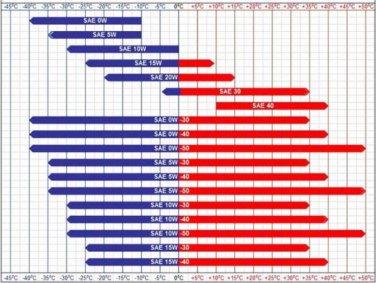

I live in Northern California where it maybe gets 30 degrees in the winter to 100 + in the summer. If I’m understanding all this right 5w30 is too thick for my climate. What if I use 6qts 5w20 and 1 quart 5w30 would that still give my Hemi the benefits it needs.

5w30 is not to thick I would do all 7 quarts of 5w30.
here is a chart that shows how they work . As you csn see 5w30 works to -30*

There are also these charts, though idk about the accuracy of all of them since they don't all have all of the grades listed.
However, viscosity for temperature is not all you should look at. HTHS, or high temperature, high sheer resistance in addition to base oil and a good additive pack are very important from what I'm picking up.
As far as Redline goes, which is what I just got delivered and am about to put in, the 5w40 and 0w40 have very high HTHS on their website. And, given the first chart below, those two give the widest range of operating temperature. With a mix of the two being the best middle ground.
However, to simplify, the first number "xW" is how good it does in cold. 10w can go to freezing or 10 below, I believe. 5w can go 20 below, and 0w cam go 30 below or farther. I'm not 100% certain in these numbers or information, but yeah.
The second number (20, 30, 40, etc) is your viscosity once it's heated up. Hemi's are rated for 20wt mainly to meet carb fuel economy standards. 30wt (and is reportedly even what's recommended in the 3rd gen RAM 2500 manual) is just fine to run, and many also run 40wt no problem as the 6.4 recommends 0w40 PUP.
I'm currently about to put 5w30 in mine and I live in Florida. Between now and the next oil change, I want to find out more about viscosity mixing and running 40wt in the 3rd gen ram era 5.7 before I pull the trigger in my theoretical ideal oil of Redline 5w40 and 0w40 mix.

I am guessing those graphs are not for synthetics? Maybe thats why they are different than the one I posted.

Dunno if those graphs are for Syn or not. I assume so, though, as [from what I know] there isn't and can't be a conventional 0w anything oil.
