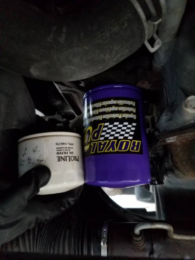

The 30-8A filter has 3/4-16 threads and won't interchange with the stock filters threads of 22mm X 1.5. To use the the 30-8a you would need to replace the nipple that the filter screws onto to the earlier 3/4-16 nipple.Not sure if you can do it on the later trucks,as I've never tried.
My truck is an 05 hemi. The 20-253 was recommended by both Amazon and Summit Racing for my truck. I manually took down the specs and looked for other filters that matched. The 30-8a was the only one, and it was larger than the 20-253. Larger is what I desired, and all sources pointed toward said filter screwing on and meshing. So that's what I ordered. Idk about newer rams/hemis, I was just trying to get the word out and let the new guy know how to find bigger filters in his correct size.
Go to summit or amazon, type in the make and model of filter you want, then set the search result filter to your vehicle, take down the filter's thread type and gasket size, then restart your original search and choose between all of the filters with the same specs as the one that was recommended based on your vehicle.

They changed the filter nipple awhile ago,not sure when,but the later hemi's all use a metric filter now,and the one you're recommending won't work on anything newer then 08,as I know for sure the 09's use a metric filter.Just straightening out your info that's all.Hate to see somebody with an 09 and newer truck buy a 30-8A filter with 3/4-16 threads and then find out it won't fit the metric 22mm X 1.5 threads of the filter nipple,especially half way through their oil change,lol.

Idk which thread I posted in but here are the fitment pics on an 05 2wd with an rp 30-8a filter. 3/4-16 threads. An 02-06/07 should accept this filter. Check multiple sources for the correct threading and gasket size to be sure. fb9c6fb7df694975dc0cc32960e81695.jpge3489132f8c0f393573c1493ca53757b.jpg

Think the majority of guys here in the 4th Gen thread have the metric filter,you should be down in the 3rd Gen section,as I've told you before,that filter "will not" fit the 4th Gen trucks,so quit pushing that damn 30-8A filter down everybodies throats,it won't fit a 4th Gen Ram.

But what is "will not"? Where there is a will, there is a way. Maybe it wont fit a stock plate, but if anyone desires the biggest filter they can find, use a relocate kit. But Hamster even though you did clarify it was for 02-07, still this is 4gen engine performance. Just say'n friend.
Gee whizz! I was completely unaware that this was in the 4th gen section! I guess using the search isn't as great as everyone makes it out to be!
I'll be sure to vacate this thread and turn off notifications, now!
Okay. My apologies kind sir. Thank you for not acting in a passive aggressive manner. :)

LMAO you're hilarious dude,i told you twice that the filter wouldn't fit a 4th Gen,and you still didn't get it figured out,so other then drawing you a picture,i don't know how else to get the message across to you,that you're promoting a filter that won't fit a 4th Gem truck.The few of us running filter relocation kits use that filter,but you still need the metric threaded adapter plate to actually fit the 4th Gen Hemi.Sorry you took it as passive aggressor,but you're a stubborn ****,lol.
On mobile, you can't see the "top" of the "page" where it tells you the forum that the thread is in unless you go to the beginning of the thread. Aka, scroll forever up. The search function brought me straight here, NOT through the sub forum. So, by design, I was actually clueless and just thought there a bunch of 4g guys on.
My bad, bro.
