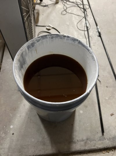

Thanks for the info I have a 5 gallon bucket with about 4 gallons in it from draining it that’s why I’m concerned

Is that your coolant or your oil, man you need to do some flushes.

That’s my radiator fluid and I had just bought all the fluid to do a radiator flush when we got back from our trip. The blown water pump was an extra adventure for the weekend
