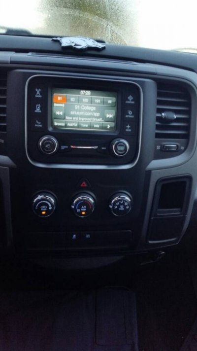

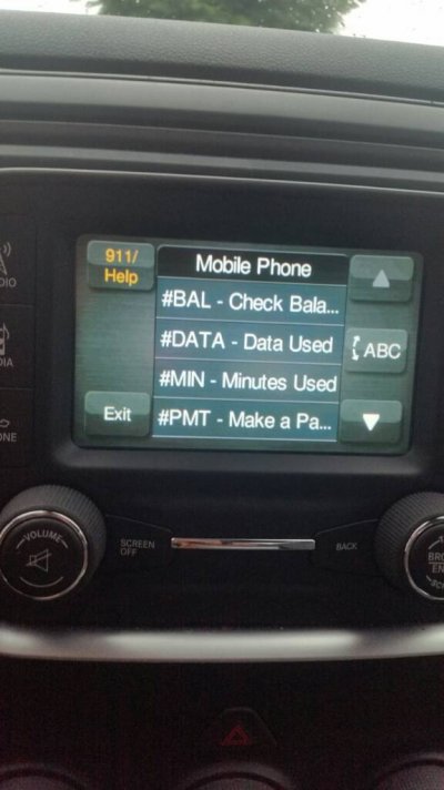

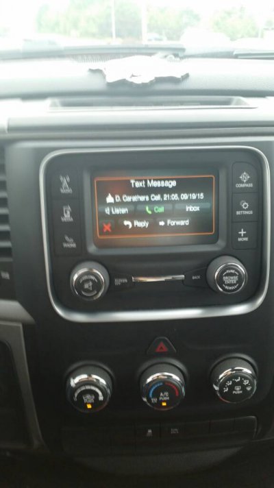

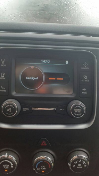

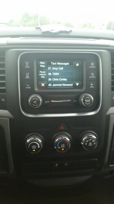

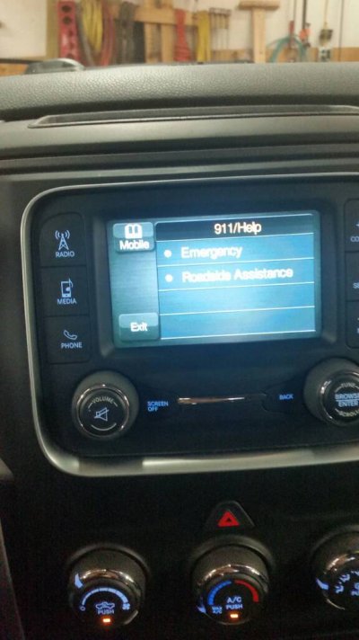

Pics below of what the RA2 5.0 Touchscreen Bluetooth radio looks like and a few of its capabilities .
And compass ! This requires an overhead console with compass module &harness install (I haven't done this yet )
And the difference btween your RA1 And the RA2
