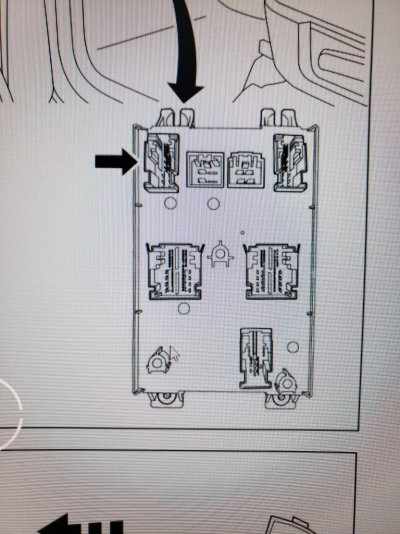

I need help to run a wire for my hood latch. 2014 ram 1500
My harness only runs from my hood latch to the connector inside of the fusebox. The connector in the picture is located in the dash above the hood release... pin #11 according to my research. I need to run 1 wire from pin 11 to the connector in the fusebox under the hood or just bypass it. I received no help from the dealer and my Google searches are failing. I need information for the crimp on wire ends i need to purchase for the connectors.

Cut it and ground it out
Then use alfaOBD to set the resistance to 500 ohm

Already programed... just need the pin that fits the connector to crimp on the wire. Doesn't detect the latch closed so cancels the remote start.
You need to run two wires from the connector under the fuse box. One to ground and the other to the BCM C1/A pos 11. Feel free to PM me if you need help.
