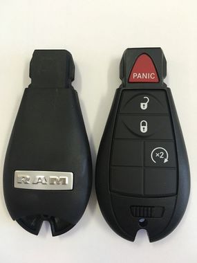

I don't think that's a OEM remote start if you have to press the lock button three times to start it. Did you get new FOBs with the remote start???
Should have a button like the one in this picture with the arrow and "x2" on it.

dont think they installed OEM remote start... The oem kit includes 2 new key fobs with dedicated remote start buttons on them that you press twice.

If you got new fobs then its an OEM unit. No new fobs then its aftermarket.
This is all you need to know. You absolutely, positively do not have the Mopar kit if it's 3x lock and not a dedicated button on the fob.
