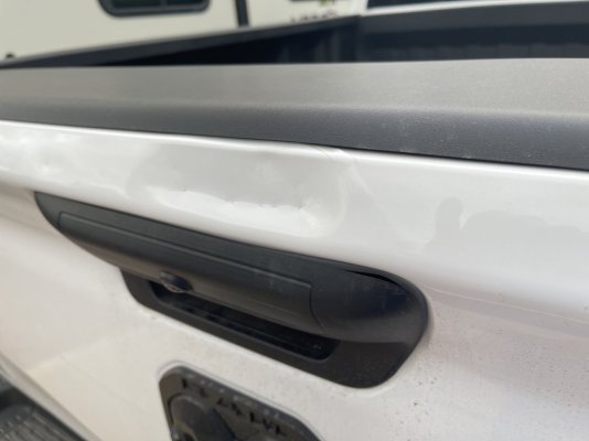

I went to the body shop of my dealer who has done work for me before on my Tacoma's. They didn't think repair was a good idea. Couldn't guarantee that it would look perfect. Suggested a replacement. They gave me an estimate for replacement with moving all the hardware to the new tailgate and they also gave me an estimate for me supplying a new tailgate and swapping hardware.
I found a company on Ebay that sells pre painted tailgates to match with a 30 day guarantee and a 99.9% rating with thousands of sales. Free shipping in both directions for $850.99
With the cost of labor, I am looking at a little over $1100 to replace it. It is an aftermarket tailgate and is aluminum, but who cares, it's just a tailgate.
Not exactly what I had in mind for my first post when I joined up a while back.

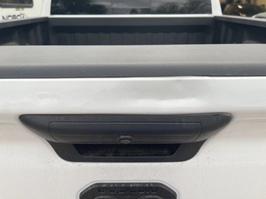

Purchased a 1500 Tradesman back in August of last year. Had paint correction/ceramic coating done after purchase.
Last month I inadvertently backed into pillar at a business backing into a parking spot. Was more concerned about getting to close to the vehicle next to me when I hit the pillar.
Did damage to the tailgate just above the latch handle .
Brought it to 2 independent repair shops and both quoted around $1500 for repair. First shop said he didn't have the equipment to work on aluminum but gave a guesstimate for what it would be, second shop seemed more like we can't be bothered price.
Knowing I can get a pre-painted new tailgate for approximately the same price with only having to move over the hardware, which is the better option?
$1500 for the repair seems like a lot for the amount of damage.
I will also go to the body shop of the dealer I bought the truck from as they do good work. I'll get repair vs replace quote from them too.

For $1500 I'd just live with it. Even if they are mostly just highway daily drivers, both of my trucks get worked in so it's just a matter of time anyway.
If you insist on fixing, its just a matter of whatever the lowest quote ends up being. I would think you could get it repaired for less than what you've been quoted so far, just need to find a shop the has the right equipment/attitude.

If you have a paintless dent repair place, maybe check with them. Not all of them will do all body panels and materials, but that looks like you could get to it from behind by popping out the handle assembly to me.

Some of you have never done body work and it shows lol. Painless might be able to get most of that out but not the creases and cracked paint. That small of a section for formed steel is more rigid than you think. Painless dent repair is not cheap around me but I don't see that coming out 100% and even if it does your looking at touching up the cracked paint to prevent corrosion. I have seen some pretty amazing things fixed by a talented painless guy and I would see what they can do. Your still going to need to address corrosion if you don't fix it as I see at least 7 points of possible rust as it sits now.

If Paintless can get the dent out for you, you can get the whole tailgate painted for 3 or 4 hundred up here. Canada is usually higher cost so no idea why they are quoting you 1500 for that job. Just make sure whoever paints it knows how to prime and paint aluminum.

A paintless repair won't work. There is a crease in the aluminum. That can't just be popped out. I would just live with it. But $1500 does sound about right for that repair.

It can be with the right tools and heat. Since the F-150 went all aluminum, it's become more popular. Like I said, not all shops will do all materials or all panels, but it doesn't hurt to check.

Thank you all for your input. I had considered trying paintless repair, but as others have said, there is the crack in the paint that would still need to be addressed. Since the truck is new with only 4000 miles, I opted to replace the tailgate with an aftermarket to save money. I updated my OP.
