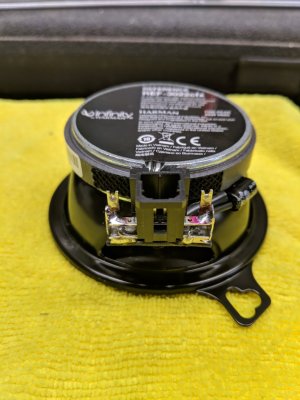

Just finished my upgrade all Infinity Ref and Pioneer 8 def worth it!
I also have a extra 3022 and harness if needed.
