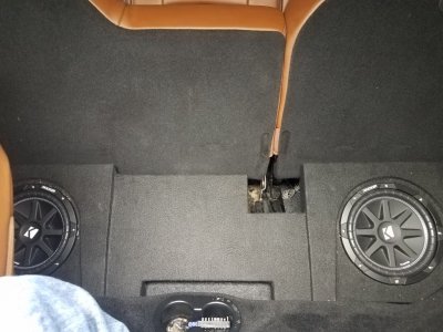

@JamesRam I used the factory subs wires under the rear seat to feed a LC2i line out converter, ran that to a Kicker CXA600.1 amp feeding 2 Kicker C10 subs. Remote bass knob for adjustments on the fly. All in, about $500 in cash and about 3 hours of labor. Plenty of bump. I highly recommend replacing the factory speakers in the dash corners, rear doors, headliner, front doors, in that order.
That setup looks good! Sound quality is good using the stock sub wires? What box did you use? I see a few options but there are a lot of poor reviews on build quality on a lot of them.

@JamesRam Everything sounds great. I do everything on a budget, so I shop my ass off for the best deals. I used this set up here:
https://www.hifisoundconnection.com...b-Box-Enclosure-CX600.1-Amp-KICKER16-PACK1758
The list price says $342, but I got it for $315. The box is fine for 2 10" subs eating 250w RMS each. I put some poly fill in, sealed the subs with caulking tape, and siliconed the terminal cups. Bumps pretty good.
The LC2i would be a better option than the Net Audio cable. It will work, but it doesn't get rid of the bass roll off. The LC2i has "Accubass" so you can clean up that roll off entirely if you want to. I got mine as an open box discount from Crutchfield for $80. As stated above, if you aren't going to add another amp for all of the other speakers, the PAC would be a waste of money. I highly recommend you replace the other speakers in the truck. The sound quality is amazing compared to our "Premium Alpine" speakers.
