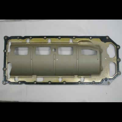

- windage tray - the pan gasket IS the windage tray lol: https://www.shophemi.com/p-238-mopar-57l-truck-oil-pan-gasket.aspx

- oil pickup/pan/windage tray: I know OEM tray/gasket is one piece but if I switched pans for better volume, etc was there a tray to consider. Was told by the parts guy at dealership that the 3G hemis are known to blow the oil pumps because of the pickups getting clogged. So understood the issue to be the pickup.

- oil pickup/pan/windage tray: I know OEM tray/gasket is one piece but if I switched pans for better volume, etc was there a tray to consider. Was told by the parts guy at dealership that the 3G hemis are known to blow the oil pumps because of the pickups getting clogged. So understood the issue to be the pickup. - where do people come up with some of this **** lol? Any engine will blow if sufficiently starved for oil. Hardly the exclusive domain of hemis. Even if you switched pans the gasket wouldn't change unless there was a change in the location of the pickup (not likely because you still have to use a sump designed for a pickup).
