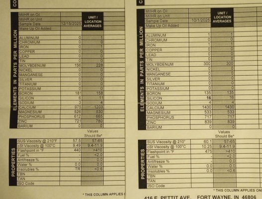

Ed, I had sent in to Blackstone Labs last October and December, two v I r g I n oil samples for comparison of:
VALVOLINE Restore and Protect 5w/30 on the left and VALVOLINE Extended Protection 5w/30 on the right ... these oils were purchased off the shelf at Wal mart.
The numbers are higher for the sheet on the right. Valvoline extended protection?
