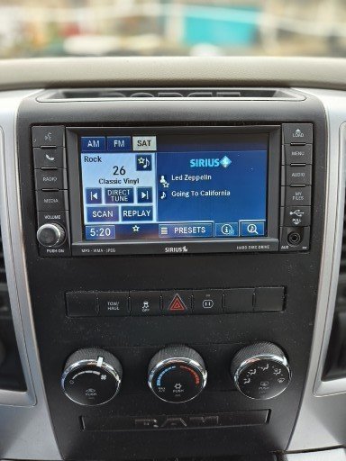

Ok, so that's the exact radio I have in your pic GTyankee and you say it's a RES 130s. When I press the phone button it reads Not Equipped with Uconnect function. So if I swap to this RBZ 430 radio it should still be plug and play? Thanks for the response's.RBZ 430.jpg
GTyankee
Nov 2, 2020
12,391
17,460
El Cajon Calif. 92021
3.0 ecodiesel
Your particular unit, in the image is a
146323824__C-RBZ-HSB__5
146323824__C-RBZ-HSB__6
Mopar RBZ 430 MyGIG Touchscreen Radio – High​
Rated 4.95 out of 5
(166 Reviews)
$499.95
IF the radio was complete, it would need the Uconnect Module
That would be found on the passenger side, behind the Right Foot Kick Panel.
Personally, i do not use Uconnect, to me, it is waste of $$$
I only use BlueTooth

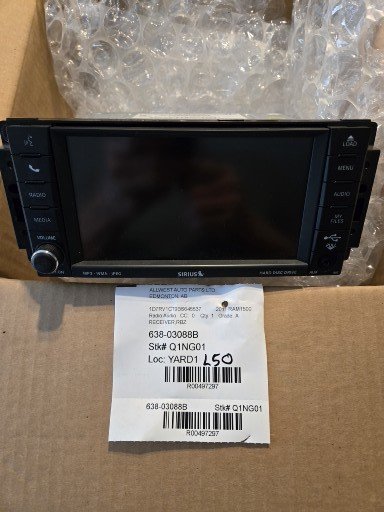

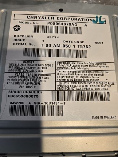

It just arrived
$130 Canadian - $20 delivery
Allwest Auto Parts
