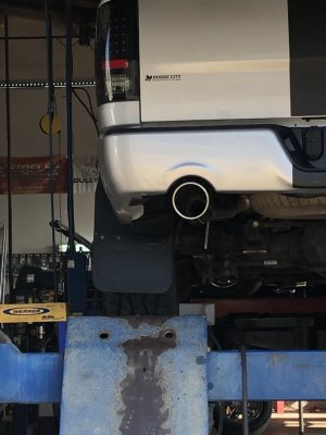

I've recently made the conversion to no resonators and added 5" tips. My system is different than most since I've got LTs with re-used stock cats welded at the collectors followed by 2.5" piping with an X-pipe and 19" Borla Pro XS mufflers. Prior to this I had the stock 2.25" tail section in play with some larger 4" clamp on tips. I finished up the system and fully ran 2.5" all the way back and installed 5" x 18" Pypes tips. The tone has definitley changed. Its deeper all around and sounds better in my opinion. There is absolutely no drone at all and sounds very very smooth. I'd personally say that removing the resonators had next to nothing to do with the increased tone depth and the 5" tips made all the difference. Since I am still running cats my system is very tame im comparison to those that remove cats and/or mufflers as this is what I wanted. I've got a heavily upgraded stereo that I enjoy listening to plus I don't think my kids would enjoy the deafening drones and bangs of a louder system. Just my 2 cents
