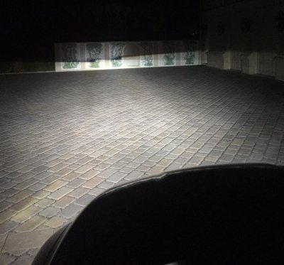

I have Spyder ccfl's in my 2012 Ram with HID's. Love the lights but the light output from the HID's isn't what I had hoped and the beam pattern/cut off is a little cockeyed. Apparently this is due to Spyder using crappy projectors (expected that). Question is, where can I get GOOD projectors to replace what's in there now? I've looked at these retrofit sites and 99% of the projectors I see at bi-xenon. I have separate bulbs for my high beams so would no-xenon projectors still work?
Yes I know my beam patters aren't even. Its harder than I thought to get them perfect...lol (I'm approx. 100 feet back from the wall)
1st pic - HID's only
2nd pic - HID's plus my Rigid Dually's
3rd pic - HID's , Rigid Dually's and 20 inch Rigid Radiance Light bar

Bixenon just means the single projector will act as low and high beams. I'm sure your dedicated high beam will still work. Theretrofitsource should have what you need.
It looks like your passenger side just needs a small twist.

Yes I agree. But I can't twist it without cracking open the housing.
