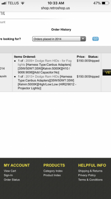

So this is what I ordered...i believe they are 35 Watt ballasts???..
Anyone know if any of the newer hid bulbs will work with my low beam ballasts

Any 9012 hid bulb will work. First, I would make sure it’s actually the bulb and not the ballast. Switch the bulbs from passenger to driver side and see if the symptom follows.
