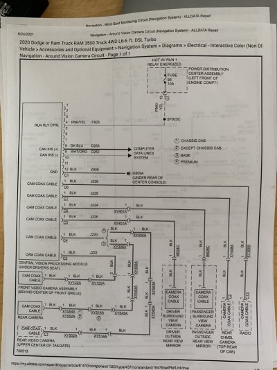

You also need a custom Harness to give the CVPM power and access to the CANBus, there's a few members on here that can help with that. Hopefully they'll see this and chime in.

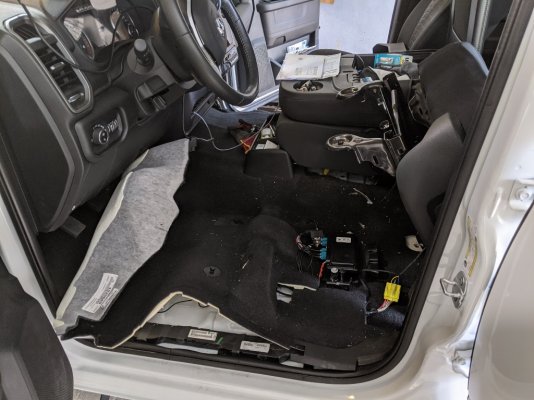

well this was exactly what I needed to find. I just bought a 2020 3500 dually limited it has most options just not the surround cams. Not sure why as haven’t seen another truck without it. I’m wondering if I need all the parts you bought like the door modules etc. I already have a back up cam but no cargo cam. I’m replacing the grille so I’ll get a new one with a camera in it. I just need to by replacement mirrors. Mine are already fully electric just missing the camera option. Hopefully you might have some insight on this. Can I also buy a used camera module or does it need to be new. I do have the diagram to add to this post. My local dealer printed this out for me. Thanks

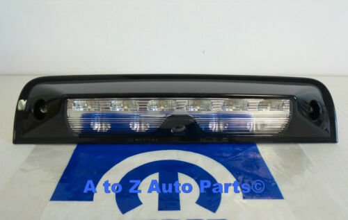

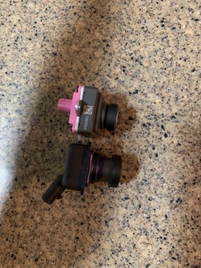

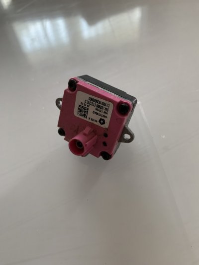

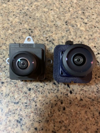

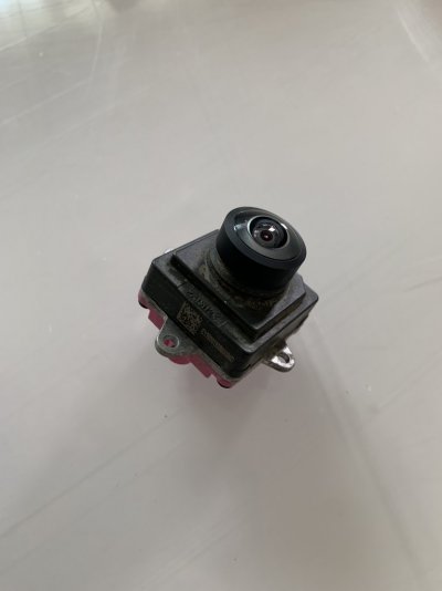

I'm pretty sure you're gonna need to get new door modules to fully support the extra features on the new mirrors like adjustable convex & reverse lights. You may be able to get away with your current modules, but you'll be missing out on the extra features.
On my truck, I had to replace the original back up camera because it was different from the one that would work with the CVPM, I think you'll be in the same situation. I don't remember if the Cargo Camera is required or not.
The front camera is a separate part from the grille, so you'll have to order the camera and appropriate mount for your new grille.
Replacement mirrors are probably the most expensive part, but if you get lucky like I did you can find them used for roughly half the cost of new.
I'm pretty sure if you can find a used CVPM it should work, all it seems to do is handle video signals, I don't think it marries itself to anything else in the truck.

The CVPM can’t process the image of your current backup camera. It has to be the same camera that is used for the front and mirrors, which also means you need the tailgate handle that accommodates the rear surround view camera.
True that junkyards don’t list many of the modules, but if you find a wrecked truck that they have that you know has the surround view system, call them up and they should be able to check for the CVPM.
The CVPM does get mounted under the driver seat on the floor.
Yes I’m aware it’s under the stove seat as my last reply. I just wasn’t sure how it’s meant to fit with the other airbag module mounted under there also
g00fy
g00fy
Aug 30, 2015
258
111
Cummins 6.7
It gets mounted to the floor somehow, I didn't really bother there's so many cables going into the thing it can't really move around so mine is just hanging out on the floor under the seat.
So this is my back up camera. You think it’s the wrong one?
That one won’t work.
On trucks equipped with surround view, there are two plastic eyelet holes in the molded carpet under the driver seat that the christmas tree push pins from the CVPM cover go through. I’m not sure if a non equipped truck has those provisions, but it would be easy to figure something out for them.

Regular backup camera compared to surround view camera:
