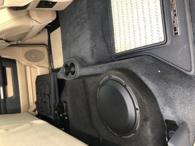

So, I have everything working now. I probably have 3 full days into it. Allot of that was troubleshooting the DSR1. The DSR1 is pretty sweet. I have it feeding a Punch 1000X5. Installed Alpine R Type front and rear with the tweeters in the stock dash corner locations. I was worried the tweeters would be too bright but they are perfect. I did set them to the -2db setting on the crossovers. I also installed the JL stealthbox. It turned out even better than I had hoped.
I did end up having to install 500 ohm resistors on the input side of the DSR1 so the stock system would see a load. It wouldn't work without them. Bypassing the factory Alpine amp makes a world of difference.
