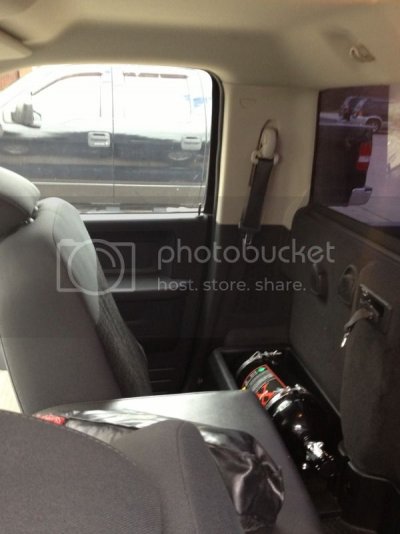

I have the bottle mounted behind the passenger seat, i have the blow down tube but no idea where to route the blow down tube through the cab to the outside of the truck. I like the easy access to the bottle. mounting in the bed is still an option

You do know that a nitrous bottle has a siphon tube in it, right?
The reason to mount them angle up with the bottle facing forward is to keep the tube submerged in the liquid nitrous. Mounting them sideways will cause them to suck air when the bottle gets low and you're accelerating quickly.
I know people do it...doesn't mean it's done right.

Looks like a perfect fit back there. And yes, just drill through that plate. Dont drill the hole any bigger than you have to in order to get the hose through there. And you can find a ton of different size grommets at just about any parts store.
Yes i do know that the nitrous bottle has a siphon tube in it. And it is angled down away from the nitrous bottle label. Which is a reason i have placed the bottle in the brackets in a 45 degree angle so the siphon tube is angled to the back of the bottle to pick up nitrous during acceleration. the bottle angle due to the mounting brackets should still push the nitrous to the bottom (opposite of the nozzle) of the bottle where the siphon tube can pick it up.
That should work right?

It will still work the way you have it. Just about all of the hemi truck guys have mounted their bottle sideways like that because of the space available in the cab. While it is more ideal to have it facing front to back, the way you have it is fine...as long as you make sure the bottle is turned so that the bottom of the siphon tube is facing down and back.
