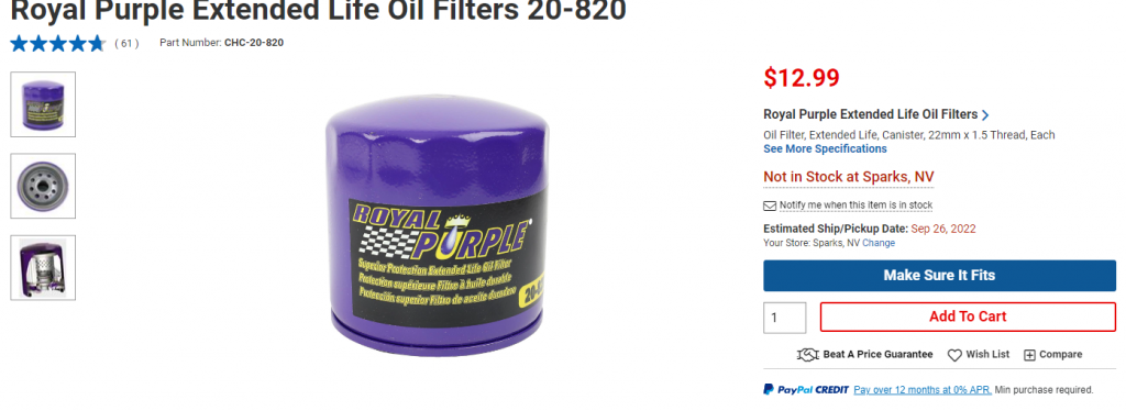

I have chatted with a few you oil gurus recently but now I am running against the clock. I am about to roll to 8k miles and I need to do an oil change. To be fair, Blackstone has told me to run past 10k multiple times I just have a hard time doing it.
Can't find any RP 20-820 filters anywhere, back-order dates are out many months...

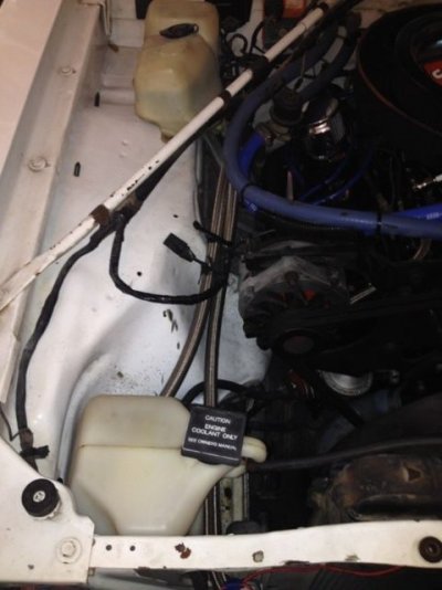

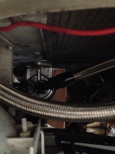

For those of you considering a remote filter location, it's one of the best moves I ever made on my old Diplomat Police car! It had a factory engine oil cooler, so I ran new braided steel lines for the cooler, and a remote filter up near the cooler, and good an fittings, and everything is leak free and oil changes are a peace of cake now and I can run a real tall filter of my choice!

Just a month or so ago Summit Racing had 9/13/2022 as the date for the Royal Purple 20-820 oil filter to be in stock. I won't be surprised if the RP 20-820 will be in stock around the end of the year. Who knows ...
