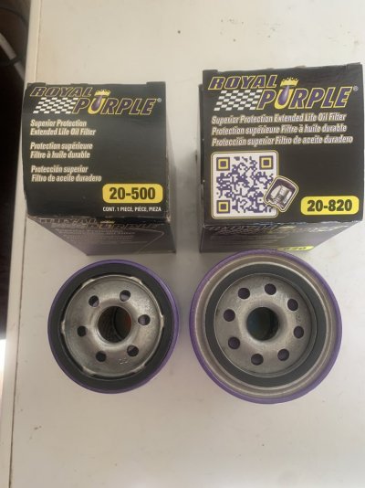

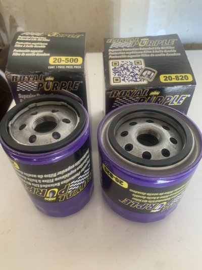

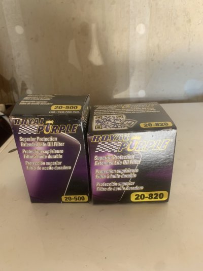

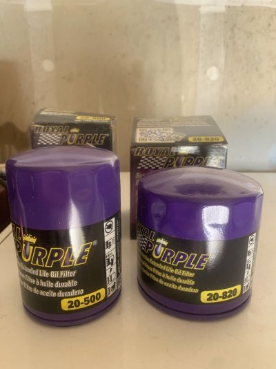

Some comparisons between the RP 20-500 and the 20-820. I would run either or.
