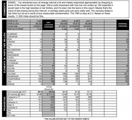

You will be able to go longer than 5k with PUP and the RP filter, myself and lots of others have our oil regularly tested, I average a bit over 9k per oil change.
Here's a thread with lots of results you can browse through:
https://www.ramforum.com/threads/blackstone-used-oil-analysis.113465/
And here's my latest result (PUP 5w-30 and RP 10-48 which is the worst one apparently):

I just can’t push myself to go that many miles. Not with an engine that has a known problem of feasting on cam shafts. But, I will say though, at least you have an oil analysis report that is telling you you can so there is that but still… Lol.

I plan to do an analysis eventually, but until then... Plus, I just did my last oil change myself for the first time, at about 62k, and that is the first time where I actually know what was used, other than "full syn 5w-20". And like @corneileous said, I can't un-teach myself the 5k rule, until I get my own results, and even then, not sure I love the 10k when the engine has a rep for doing rude things to itself. I also am looking at it as "cheap insurance". The extra changes when I do them, still end up only costing me a few $ more than I was paying the oil change places for the "dealer interval". Versus the cost of a new engine.
And to be honest, I only actually understand the bottom part, and the report saying "you can go 11k on this".

Lots of data around:
My truck has been on the PUP/RP combo for over 50k with the same average oil change intervals, I'm just about to roll over 100k and I'd still do it all the same (except I'd change to a bigger RP oil filter now that I see how much @Burla hates the 10-48).
