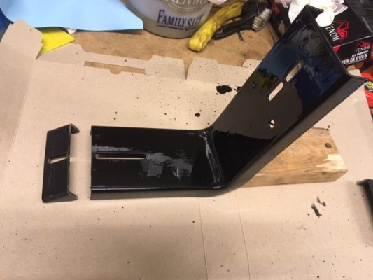

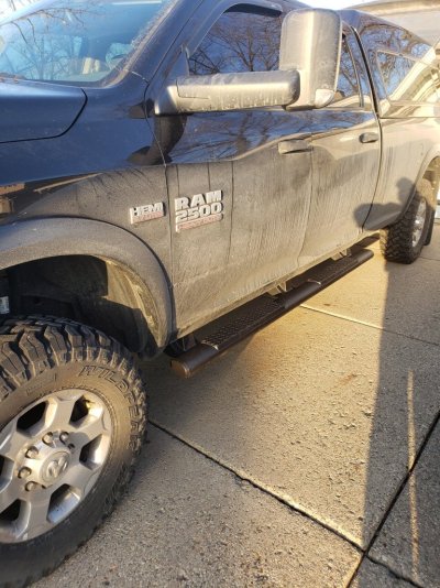

I have installed the Ionic Factory Style running boards on my 2016 Ram 2500, my 2016 Ram 1500 Sport, and I am in the process of installing them on my 2022 Warlock.
My main motivation for installing these is to protect the rockers and door bottoms from salt and snow in the winter.

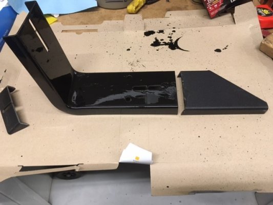

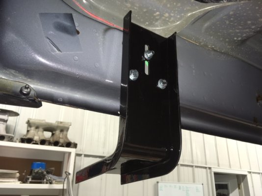

As you know, the brackets that they recommend (Part #82080) bolt to the pinch weld. However, part #82067 bolts to the inner rocker and does not touch the pinch weld.
I did need to make some modifications that I don't think I had to make on the 2016 trucks. I had to cut down the vertical part of one of the brackets on each side because it was hitting the floor pan. I then had to bend it so it matches the other two brackets and drill a couple holes to bolt them to the rocker in the factory threaded holes.
I also shortened the horizontal part of the brackets that the running boards sit on so that I could tuck them in under the rocker a little so they completely protect the pinch weld on the bottom of the rockers.
I then bead blasted the brackets, scuffed them with Picklex-20, and gave them two coats of POR15.
My 1500's are quad cabs. The Ionic boards they specify for these are a little too short for my liking. They left the cab corners vulnerable. So I ordered the ones for a 2014 F150 supercab. The are slightly longer and shield the entire cab. I also have some mud flaps to install. This setup has worked great to protect the truck.
I also sprayed Transtar Amber cavity wax in the rockers (both the inner and outer) so it seeps into the pinch weld and solidifies. Doors too. Probably not needed where you are in Florida.
GSSS
Jul 5, 2018
42
16
Minnesota
Thought I would add some pictures in case my description wasn't clear. The first 2 pictures are of one of the two longer brackets that I had to trim both ends. The third is the bracket loosely mounted on the truck. According to the instructions, these should be the rear most brackets but I used them in the front position.

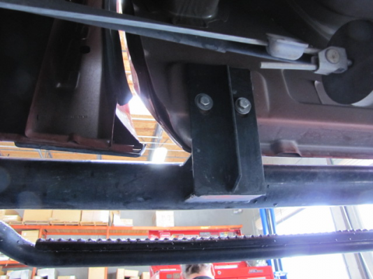

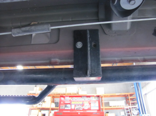

After i bought my 2009 Dodge Ram
finding anything on the shelves in auto parts stores at that time was close to impossible.
I went to a muffler & accessory store & they had samples mounted on the walls
I wanted a 3 step nerf bar, but the factory told us that they were only making two step nerf bars, until inflation stabilized.
So i went ahead & bought the 2 step N-fab bars, they were on my 2009 right up until i switched them over to my 2016 & they are still in place
We cut off the rear step & bought some metal & shaped it to make a new longer rear step, then it went to a powder coating shop
Front mount
Middle Mount
Rear Cab Mount
I currently weigh 320 pounds :( , when i step on the bar, the bar does not move, just the truck does
