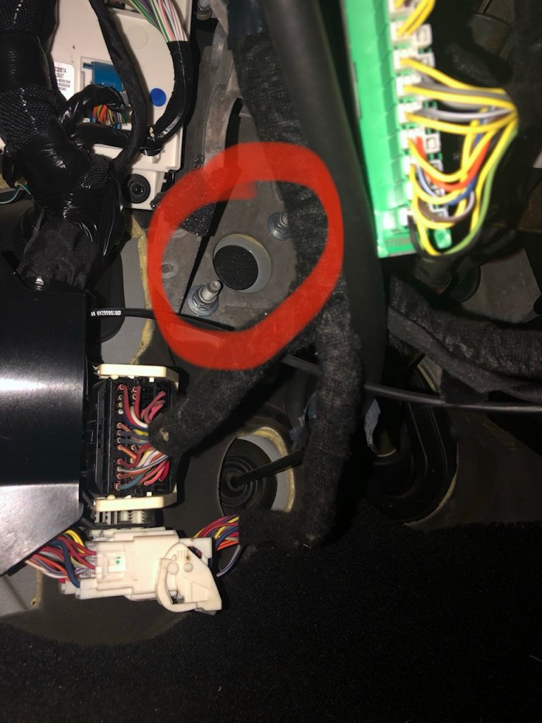

I have no past experience running wires through firewall but I saw this up under the driver side pedal area:

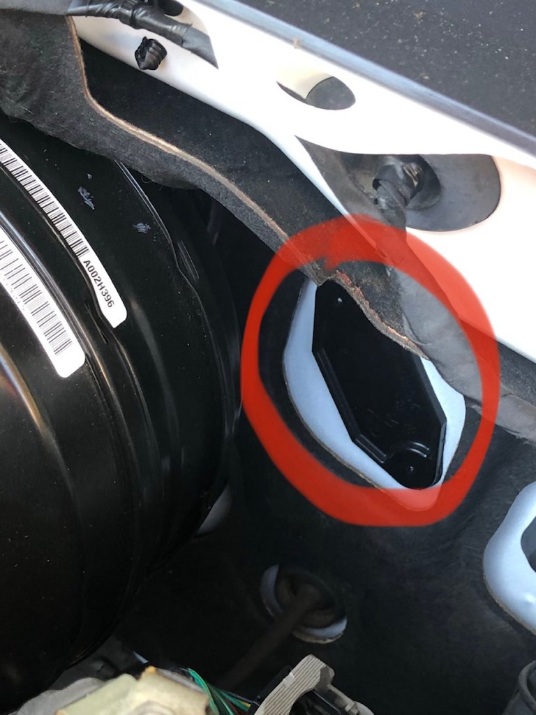

And under the hood it looks like:
Can I just unbolt this thing and run wires through there??? I'm not sure what else it's for but it almost looks like it's made for this.
If the answer is no, then could you please suggest another area? My battery is on the driver side pretty close to there. Any other advice for running these cables or for the antenna cable, which I'm going to have to mount as well?

That's exactly the spot I was going to use. I'm going to run a grommet in there, then run a 8, 12 and 18 gauge wire through it.

I ran my OEM backup camera wires thru there as well as my amp power wire thru there. Great place to pass wires thru!

I drilled out the circular center of that piece and inserted a rubber grommet.

did the same- drilled out the center and used the rubber firewall boot as mentioned in the other thread. If you are passing a lot of wires, you might want to cut the smallest ridge off, and start with a larger opening. it gets harder to pass wires later on and the boot will invert itself. Ask me how I know.

I always use the clutch block off plate as well in the trucks I do. Its easy to remove and drill a hole in and insert a grommet or you can drill it right in the truck if you chose. I used to try passing the wires through the rubber boot in the cab but it's a major pain. The clutch block off plate works just as well and is much easier

I just got done taking that plate off, drilling it and reinstalling it. I'll say this, using a standard socket wrench sucks horribly. It was a pain in the ass to get the nuts off. When reinstalling it, I said F the socket wrench and used a ratcheting box end wrench. That is way easier and faster than a socket wrench. I wish I would have thought of it during the removal.
This is assuming you don't have a power tool that can do it.

I used my cordless drill with socket attachment. Makes for quick work :)

I started with a socket/ratchet but quickly switched to an air ratchet

^this for me too. I used this grommet/boot when I pulled wiring in that location. https://www.amazon.com/Daystar-Univ...0&sr=1-1-25b07e09-600a-4f0d-816e-b06387f8bcf1
