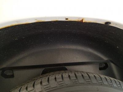

I'm so bummed out. While detailing my 2014 ram I found this rust in the left rear fender lip. My first thought is to sand it off treat with rust reformer and repaint. It looks like in the worst spot it's getting awfully close the the outside visible part of the fender though so I'm kind of freaking out. Anyone else have this What would you do?

Sand, Rust treatment, rock Gaurd and fender flares.
Yep that's what I did. Take out fender liner and sandblasted the **** out of it. Put on a Rust encapsulator and primed and painted with a can of factory paint and then put on fender flares. You want to stop it now

Sorry, but its already to late once you spotted it like this. They rot from the inside to the outside. (sorry again, but its made from chinese recycled metal - it is what it is)
Even if you fix it, it`ll come back, and with each time, it will be worse. Nice thing about it is, is that they still make new trucks everyday, out of the same garbage metals.
You`ll never stop it from rusting... As others have said, sand it, treat it, paint it, move on and live with it, or, buy a new truck.

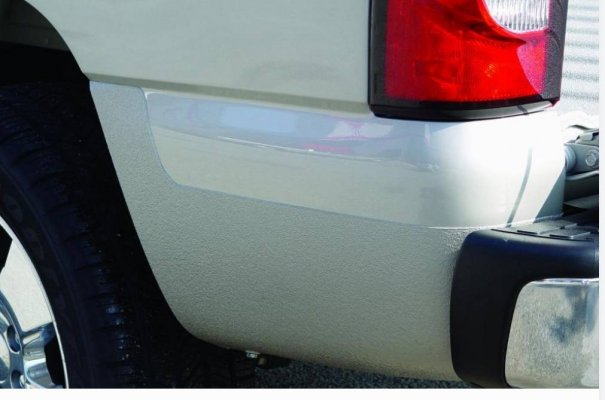

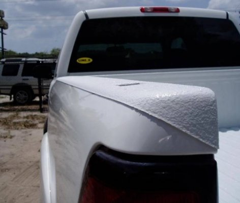

Line-X the rough rubber coating like you find in the box of your truck.
i don't understand how that would look. My truck is white so i don't want to see black where the flares meet the side of the truck

You can see the spot welds where the rust is in those pictures
Once you take out the plastic wheel well liners , you will see the inner rear quarter support that is spot welded to the bedside on both sides
Spray inside that support from the backside thru the open spaces with fluid film and plastic wands , spray the hell out of it between the support structure and bedside
It will drip down and coat the areas you can’t reach
Helps to remove the rear tires and jack up the frame
You will see once everything is removed
Start there first
