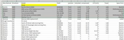

Should be a sticky! ^^^^^
And that's my old list. New one have have a bunch of others things we have from struts to coliovers, rear shocks, front ucas, rear ucas, trackbars etc etc. i think i had it last year around here but it's been updated it since then. everytime i see something new i add to it.
