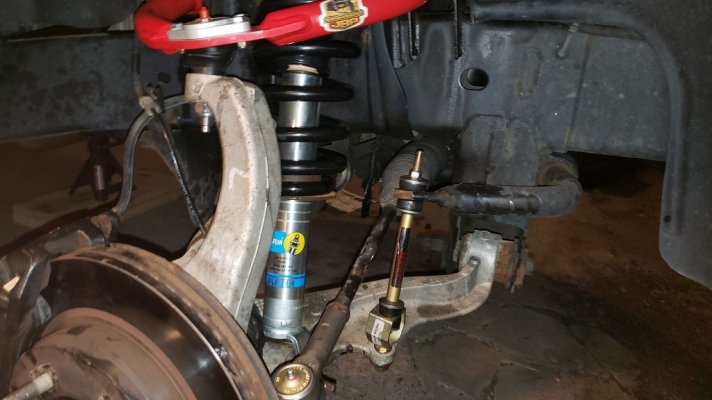

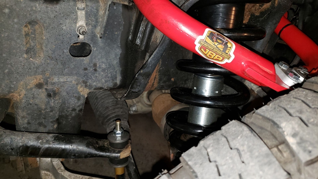

I actually did Bilstein 5100s all the way around on mine about a year and a half ago with the adjustables up front set at 2.8. While I was at it I also upgraded the front UCAs to JBA, the sway bar links to Suspension MAXX, new MOPAR front springs, and on the rear went with all CORE 4x4 (UCA, LCA, trackbar, and links), and TUFTRUCK TTC 1211 springs. Handles far superior to the stock stuff...IMHO. I do mostly highway driving so road comfort is a must for me. I just went to Nitto Ridge Grappler 35x12.5 after putting over 60k miles on my Toyo ATIIs (305/55/20). Here's how she sat with the 305s and how she sits now. I chose the 5100 setup for the ability to "level" my truck and give it a modest lift.

Thanks. After having to fight it a few days ago changing the driver's side lower ball joint (previously had the Moog problem causer) which didn't want to come off. Had to MacGyver a ball joint tool so I could release it. Passenger side was still fine according to my tire shop, but since the weather will be nice tomorrow I'll be changing the passenger side anyway. Pretty sure it's still the original.
Anyway, to the OP...depends on your preferences. I had Icons on my Titan then went to Ranchos and was much happier. Decided against them on my RAM when I went with the Bils because I didn't have the ability to adjust the height up front. I've noticed some new RAMs at my local dealership are being modified with a 3" lift at the dealership and using Fox shocks, but everything else is still MOPAR parts (UCAs, LCAs, links, etc). The $$$$ on the Fox and Icon were another issue for me where I was able to get what I wanted with the Bils and had $$$$ for other stuff. I've gotten about 50k miles on my truck since I've done the upgrades. No issues from my suspension upgrades. Just my old stuff now exceeding its service life!
