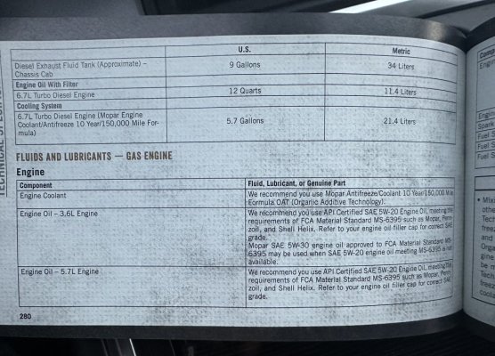

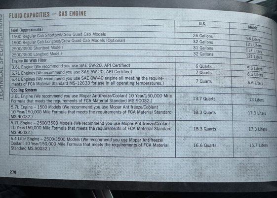

You know, there’s people on this site that really push 5W-30 engine oil which, for those of you that do, I’m not saying you’re wrong, I’m just using it as an example so how was I supposed to know that 140 recommendation was legit?
I don't know if all year manuals have this or not, but:
NOTE: MOPAR® SAE 5W-30 engine oil approved to FCA US Material Standard MS-6395 may be used when SAE 5W-20 engine oil meeting MS-6395 is not available.
and, in an older manual when 2500s could still come with one:
For 2500/3500 trucks with a 5.7L engine operating under a gross combined weight rating of 14,000 lbs (6350 kg) or greater, SAE 5W-30 engine oil is recommended for all operating temperatures.
Sometimes different year manuals recommend different things and nothing mechanical has changed, which isn't unique to Ram. Lighter oil to eek out a bit more fuel economy or heavier oil after failure analysis, etc.
Sometimes different year manuals recommend different things and nothing mechanical has changed, which isn't unique to Ram. Lighter oil to eke out a bit more fuel economy or heavier oil after failure analysis, etc.
Yeah, the manual for my 3rd gen 1500 said that and being in that I came to the fourth generation ram truck at the very end of the game, I don’t know which trucks that was ok for but I can tell you that manual for my truck doesn’t say that.
But you know, this isn’t an argument about what dodge or ram used to let us do versus right now; I only referred to the PDF version of my manual on the Mopar site which, if I would’ve known better, I would’ve ignored that and looked up what it said in my own printed paper manual.
The only reason why I made the reference to 5W-20 or 5W-30 engine oil is because of how a lot of folks on here and other places, even if your manual doesn’t say that it’s OK to use 5W-30 in place of 5W-20, they’ll still tell you to do it anyways so how was I supposed to know this wasn’t one of those times when one or two people told me to use 75W-140? Because like I said, I had already read what the Mopar website manual said to use which was 75W-90 weight and unless I missed it, I never saw where anybody said anything like if you have the 3.92 rear end, the book actually calls for that specific weight.

Read the note at the bottom,this is from the 700 pg printed manual which you don't have,you used to have to phone to get it.Even Ma Mopar says 5W-30 is okay to use.It used to also be in the online manuals up till about 2018,then they were forced to remove it,because apparently the trucks didn't meet they're claimed milege numbers good enough for the nannies in power
