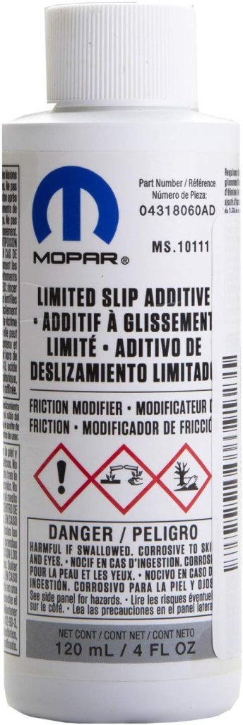

Yeah, but isn’t that only under like severe conditions for frequent trailer towing and off-roading and such? I mean, I’d have to wait until I get home to see what it says in my book, but I don’t think it really has any kind of a maintenance interval that soon from what I remember. I’m not contesting what you’re saying, I’m just saying.
Mine got the shudder without heavy towing around the same mileage. Had the differential fluid changed at the dealership and while better it still had a studder.
I then added some limited slip additive as was suggested on this forum and was gone almost immediately.

So the dealership didn’t tell you that because you have a limited slip rear end, you needed that friction modifier? I guess in a way that’s understandable because that red line performance gear oil that I put in my rear differential supposedly has friction modifier added to it, I just don’t know how much and regardless of how much that it supposedly had, I went ahead and added the proper 5 ounces to it.
But it’s funny that after you added the friction modifier that your shudder went away after your gear oil change because that tells me that the previous oil you had in there, your friction modifier that was in there probably got worn out to the point where it wasn’t allowing the clutches in your rear diff to slip like they’re supposed to.
