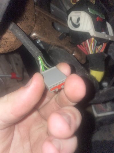

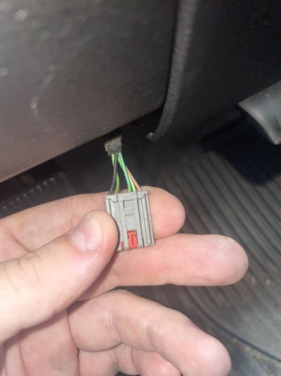

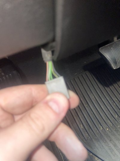

Hello, I have a 2020 Ram 2500 Laramie with the 6.7 Cummins. I recently bought the truck used, and found a gray six pin connector under the dash. It is close to the OBD2 port.
Any ideas what it is supposed to connect to?
Additional Information:
On plug Writing (back side): JST CBJ
Found it to be CE6373 on connector experts
Mopar Part Number (I believe):68499646AA
Here are some pictures:IMG_1292.jpeg
GTyankee
Nov 2, 2020
12,391
17,459
El Cajon Calif. 92021
3.0 ecodiesel
This is a just a guess
It may be part of the OEM Integrated Brake Controller
This video may show it
check at the 4 minute 45 seconds point
Jimmy07
Feb 23, 2017
3,502
3,535
Here are some pictures:View attachment 548129
Inverter switch for trucks equipped with bed mounted 120 outlet.

My guess would be like GTyankee. I would say brake controller prewire from factory. Do you have a factory trailer brake controller already installed?
RamDiver
Jan 23, 2022
5,571
11,760
Marlborough, Ontario Canada
2021 DS
The connector at 4:45 in GT's video looks different to me.
It does look remarkably alike to this connecter I pulled up by searching DJ and 'switch-inverter' here.
Yep can confirm, this is it. The connector and pin out matches.
Thank y’all. I am in the process of troubleshooting the passive entry, and wanted to confirm this was not a missing module for it.
