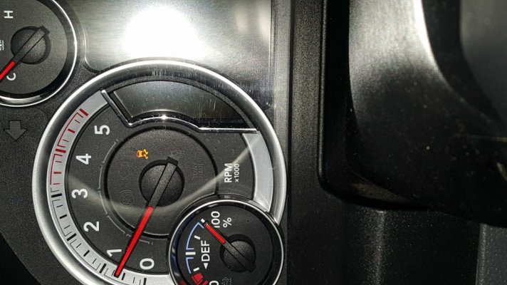

Slipping light is on and won't turn off at all, cruise control won't work either. I work all the time so I really don't have a chance to take it to get serviced. Has any had a problem like this, or know a quick solution? I have a long trip ahead and would like my cruise control.887e15ce4f31aa830f199f12107b20cf.jpg

Guessing there is an issue with a rear wheel speed sensor or speed sensor in the transmission.

Would you happen to have a picture of either of them

Wheel speed sensors are usually bolted in to the axle around the wheel bearing. The transmission speed sensor would probably be around the output end, maybe on the transfer case. No pics but you could probably Google for them. I would probably suspect the trans sensor first as the wheel sensors would throw an ABS code and light.

So most likely it'll be loose

It might be loose, the wiring could be damaged, or the sensor could be bad.

Alright thanks do you think the msg service electronic break system might be the cause

Probably a wheel speed sensor. Everything else likely related to that.
