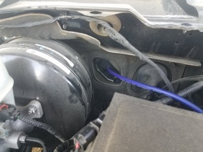

There is a small blank panel to the left of the steering column. A 3/8" hole was perfect for the power wire.

I routed all of the wires for the amp under the sill plates. I tied the power cable to the brake cable shield to keep it tamed and out of the way.

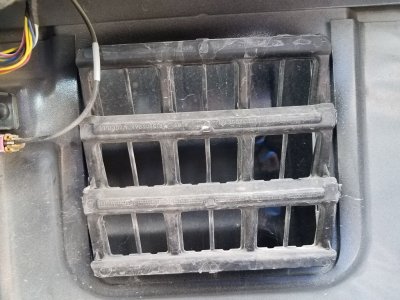

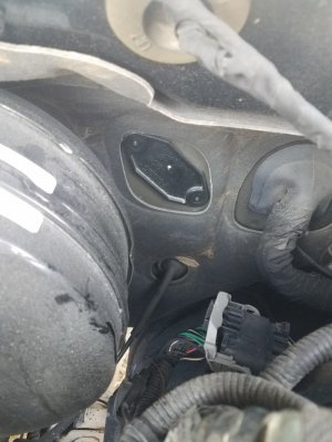

The box fit with no issues, and the little 600W amp takes up very little space. With this set up you do not have to have seat spacers, but it may help the sound a little. You will lose your fold out trays. Something I noticed on both trucks. The pressure relief vents in the rear of the cab do not have flaps to block dirt and dust and water. I thought my truck was just a fluke, but I checked the other truck and it is the same. I had been getting water in my truck occasionally, and assumed it was the third brake light. I sealed and re-sealed it ten times and was still getting water. Now I think it is coming through these vents. I will make some flaps for these for sure.

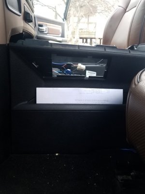

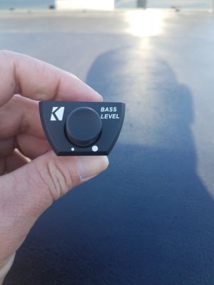

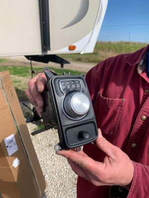

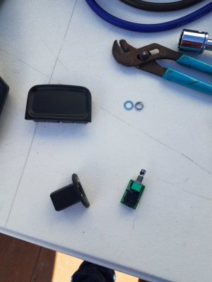

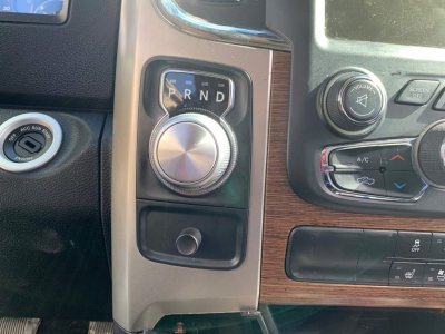

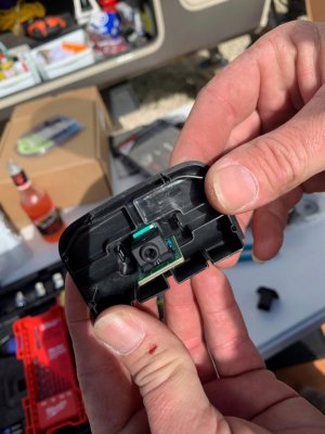

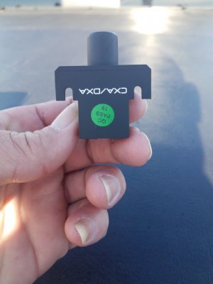

20 years ago when I did my last stereo install, we didn't have bass boost remotes. I thought these were pretty cool. I didn't like the flange mount design though. If I were to mount this under my dash, my 6'4" 210# body would knock it off daily. I decided to disassemble the switch and flush mount it in the blank below the shifter for the 1/2 ton, and in the blank panel of the console for the 3/4 ton. I wanted to put it in the same location for the 3/4 ton as the 1/2 ton, but the circuit board for the shift on the fly 4WD control is in the way.

On the half ton, I tapped into the door speaker wires behind the panel next to the seats. Rear Left + Grey/Dark Green, Rear Left - Grey/Light Green, Rear Right + Dark Green/Light Green, Rear Right - Dark Green/Grey. For the 3/4 ton I just used the factory sub feed wires. Put everything back together and connected the inline fuse and battery. This package will not win any competitions, but it sounds really nice with the upgraded speakers. Much better blending of the highs and lows. But if you want a little extra kick, just give that bass knob a spin.

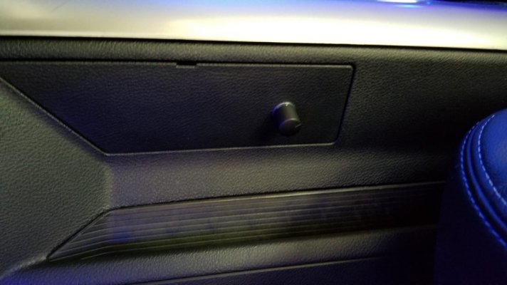

Installed mine today, quick and easy. Out of the way but easy to get to as well. :waytogo:
Positioned it towards the rear in case I want to add other items later.
