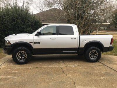

2017 Rebel. I went from 285/70-17s to 305/70-17 with no issues.
A Rebel with the conventional coil spring suspension has a higher ride height from the factory vs the Sport trim truck, could make a difference.
