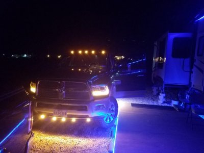

I love my LED clearance lights. Smoked lens as well. The ugly white warts up top killed me.

Which smoked lenses do you have?
I got the cheap Partsam ones from Amazon. The reviews for the Recons at three times the price were the same, so I figured why waste the money? I reused the rubber gasket from the factory lights, with black RTV between the gasket and metal of the cab, RTV between the gasket and the light housing, and dipped the screws in RTV to seal the threads.
Here's a link:
https://www.amazon.com/Marker-Light...-18744-3114-----6-0&sr=1-14&ymm=2014:ram:2500

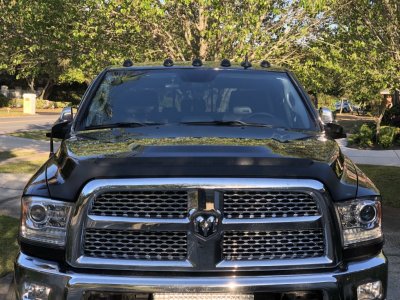

Well, after some procrastination, work trips, a vacation and waiting on the weather, today is the day. Yes, I’m still scared... lol

Looks great on a dark truck. Nice job. What kind of dash cam are you using?

Thanks! The wife got me a Vantrue N2 Pro for Christmas.

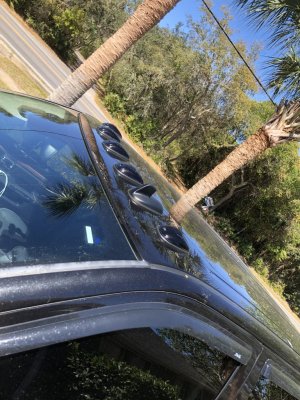

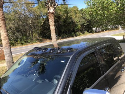

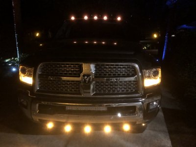

Here are more pics. Pay no attention to the pollen.
